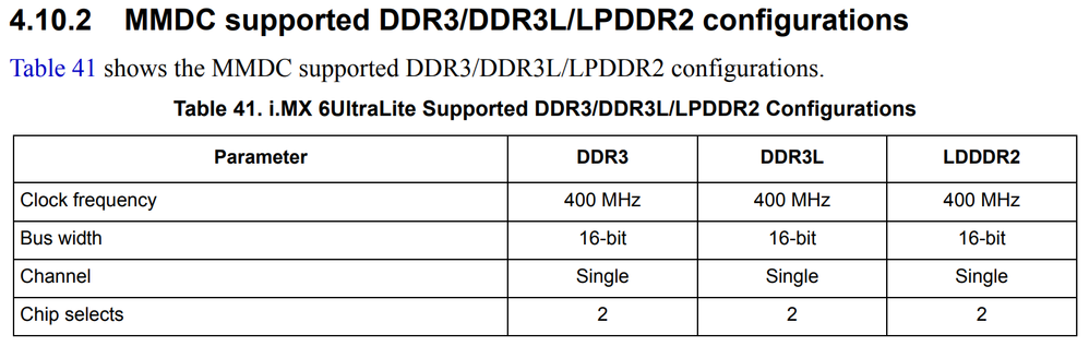

This is caused by the max operating frequency for DDR3 in i.MX6UL, please refer to datasheet:
