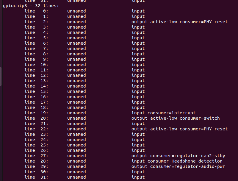

i am using imx8mplus custom board and build the yocto BSP 6.63 version
. i want to blink the led using gpio pins.
my leds are connected to GPIO3_19 ,GPIO3_20 ,GPIO3_21 ,GPIO3_25.
by default this pins are ouput direction .
i added the python3-gpiod package in local.conf.
i wriiten python program using gpiod to blink the leds . my program is running without errors  but leds are not blinking.if anyone know how to blink leds please help me out.gpiochip3.png

It appears you did not modified your device tree, you can add the following to your device tree:
&gpio3 {
	pinctrl-names = "default";
	pinctrl-0 = <&pinctrl_gpio3>;
	status = "okay";
Then, inside of the &iomuxc:
pinctrl_gpio3: gpio3grp {
		fsl,pins = <
                        MX8MP_IOMUXC_SAI5_RXFS__GPIO3_IO19      0x40000
		                MX8MP_IOMUXC_SAI5_RXC__GPIO3_IO20	    0x40000
                        MX8MP_IOMUXC_SAI5_RXD0__GPIO3_IO21	    0x40000
                        MX8MP_IOMUXC_SAI5_MCLK__GPIO3_IO25	    0x40000
Then, you will be able to change the state of the pines with your code
The above is working fine for led blinking of gpio3 pin 19
could you please explain this what is 0x40000 and which register it configures.

Sure, the register configured is SW_PAD_CTL_PAD_SAI5_RXFS SW PAD Control Register
(IOMUXC_SW_PAD_CTL_PAD_SAI5_RXFS):
You can find more information in reference manual.
