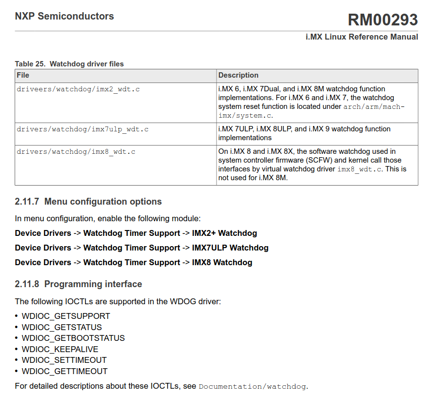

DavidFlir
Reading the often referenced Linux reference manual, I see:RM00293-22.11.7.png
The files I do not find are related to IMX8 Watchdog.
Also not here in the Sept 2025 release ->  https://github.com/nxp-imx/linux-imx/tree/lf-6.12.34-2.1.0/drivers/watchdog
So the documentation is outdated?

Chavira
Hi @DavidFlir,
Are you using an iMX8 or an iMX91?
In Table 25, you can see that we use the imx7ulp_wdt.c driver for iMX9 devices, which includes iMX91, iMX93, and iMX95.
For iMX8, we use the imx8_wdt.c driver, as its architecture is different from the iMX9 family.

DavidFlir
I am using the iMX91, so I don't need the non-existing imx8_wdt.c-driver.
