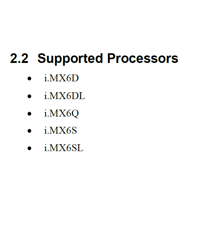

I'm sorry but I find that in Integrating Processor Expert for i.MX and ARM GCC with Eclipse
also:
i.mx6 soloX is unsupported :smileyconfused:, where is the hello world example in cortex m4, Thanks for helping me :smileyhappy:
8,399 Views
Yuri
The recent release (1.0.1) of the Processor Expert does support i.MX6 SX.
Yuri.
