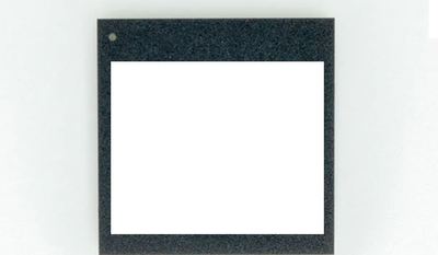

Zhiming_Liu
Let's check the chip id on top of soc.

okuda
The image of SOC has been uploaded.
Can you see this image?
