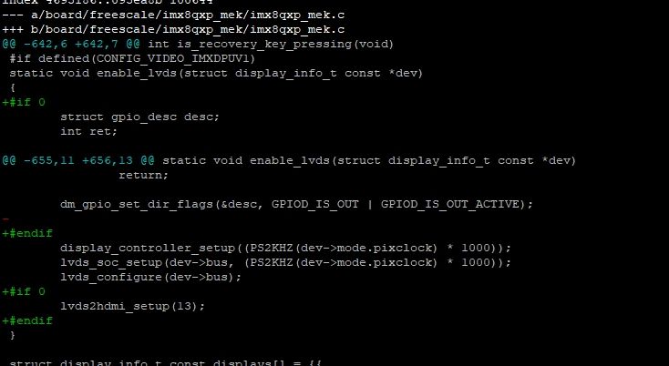

Our new layout i.MX8QXP board can not boot up,
here is the log.
Is there anyone can help me to fix this issue,
thanks

xinchuan
Hi Igor,
      Thanks for your reply.This issue is fixed by modfiy uboot imx8qxp_mek.c file.
辛川

xinchuan
hello,
以下为改动部分
