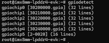

    • The command gpiodetect works as expected and lists all available GPIO chips.

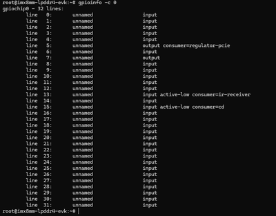

    • The command gpioinfo also functions correctly, displaying information about GPIO lines.

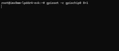

    • However, when I attempt to use the gpioset command to set a GPIO line, the terminal becomes unresponsive. The GPIO pin does not change its state (remains low), and I must terminate the process manually using Ctrl + C

Hi @dhananjay896 :
In order to configure GPIO using libgpiod library, you need to
  1. make sure no other driver this this GPIO
  2. configure the pin as gpio in dts file
please see my test result:
root@imx8mmevk:~# gpioset -c gpiochip2 16=1 //you will see the led light on
//ctrl +c force quit
root@imx8mmevk:~# gpioget -c 2 16
"16"=active
root@imx8mmevk:~# gpioset -c gpiochip2 16=0 //you will see the led light off
//ctrl+c force quit
"16"=inactive
root@imx8mmevk:~#
