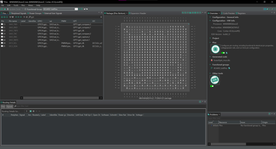

Is there an excel file with the pin table of i.MX8M Plus that contains all the pin mux information?
Specifically, I want to know all the pins that I can use for the GPTs Capture 1/2 inputs.
I need a couple of capture inputs for my design. Thanks.

I suggest you use Config Tools for i.MX to check that information.

I try using the tool. The part number is: MIMX8ML8DVNLZAB.
There is only 3 GPT instead of 6 stated in the datasheet. And only GPT1 has 2 capture inputs.
How do I make all the 6 GPTs and the 12 capture inputs show up in the tool? Thanks.

Some of those GPT modules are used by Linux as is mentioned on Linux Reference Manual (Section 2.1.3).
The only GPT modules that can be routed as is mentioned on i.MX reference manual and Config Tools for i.MX are showed on last image.
