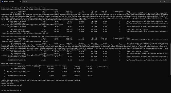

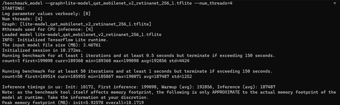

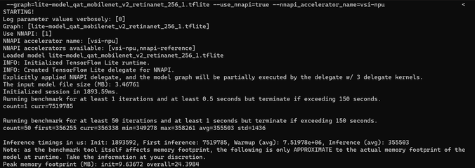

This one does not run on NPU:
https://tfhub.dev/google/lite-model/qat/mobilenet_v2_retinanet_256/1
Log:

Hi @drewg
I have been working on this case using the benchmark_model for Android as described on the i.MX TensorFlow Lite on Android User's Guide.
Here are the benchmarks.
First, I tried to get benchmarks for Android with the model lite-model_qat_mobilenet_v2_retinanet_256_1.tflite, that you are trying to accelerate on the NPU.
Benchmark for CPU with 4 threads
Command:
./benchmark_model --graph=lite-model_qat_mobilenet_v2_retinanet_256 1.tflite --num_threads=4
With the above log you can see the average inference time is 187487us or 187.5ms.
Benchmark for NPU
Command:
./benchmark_model --graph=lite-model_qat_mobilenet_v2_retinanet_256_1.tflite --use_nnapi=true --nnapi_accelerator_name=vsi-npu
You can see the difference with the NPU average inference time is 355503us or 355.5ms.
Command:
./benchmark_model --graph=lite-model_qat_mobilenet_v2_retinanet_256_1.tflite --use_nnapi=true --nnapi_accelerator_name=vsi-npu --enable_op_profiling=true
Also, I enabled the profiling option, you can see the nodes and their implementation on CPU and NPU.
With this information, we can see that the model can run on the NPU but with a bad performance (CPU 187.5ms - NPU 355.5ms) related to the Android Ecosystem for TensorFlow Lite.
I will work on this issue and update you as soon as possible.
