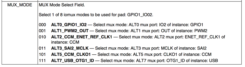

I have found an inconsistency in the i.MX7 dual reference manual, and it would be helpful to me to know which part is correct.

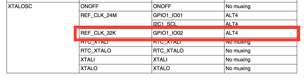

I want to get at the 32k XTALOSC clock.  I note that the mux options in IMX7DRM, Ch 8, lists the following:
To me, this says that if I configure mux option Alt4 on the GPIO1_IO02 pad mux settings, that I will get the 32k XTALOSC signal as an output on that pad.  However, when I look at the actual mux settings for that pad, there's no mention of Alt4, nor of XTALOSC.
So, will I get a 32k clock if i set ALT4?  Is this supported?

  REF_CLK_32K option of GPIO1_IO02 is available.
You may use the Pins tools V3.0
http://www.nxp.com/products/software-and-tools/software-development-tools/processor-expert-and-embed...
Thanks for the information about i.MX7 RM inaccuracy.
I informed the doc team  about it.
