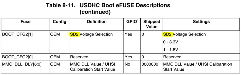

Hello Champs,
In the RM ver2, BOOT_CFG2[1] looks to be allocated only for SD2.
This is a typo and actually true to all of 4 uSDHC ports, right?
Nori Shinozaki
1,774 Views
igorpadykov
Hi Nori
Table 5-4. SD/eSD Boot Fusemap  RM (address 0x470[7:0])
provides other uSDHC ports selection through fuses. GPIO option
only for SD2.
igor

1,774 Views
norishinozaki
Contributor V
Hi Igor,
Thank you!
Nori Shinozaki
