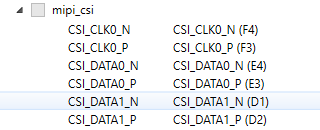

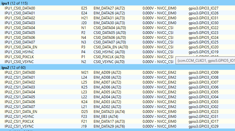

We have an requirement to connect 03 cameras to i.MX6Q processor, Will below hardware interface works to stream all three videos parallel.
1. Parallel interface --> 02 cameras
2. Mipi interface --> 01 camera.

Hi Chandra
this solution is feasible if there are no muxing pin conflicts, also may be useful to check
iMX6DQ MAX9286 MIPI CSI2 720P camera surround view solution for Linux BSP
