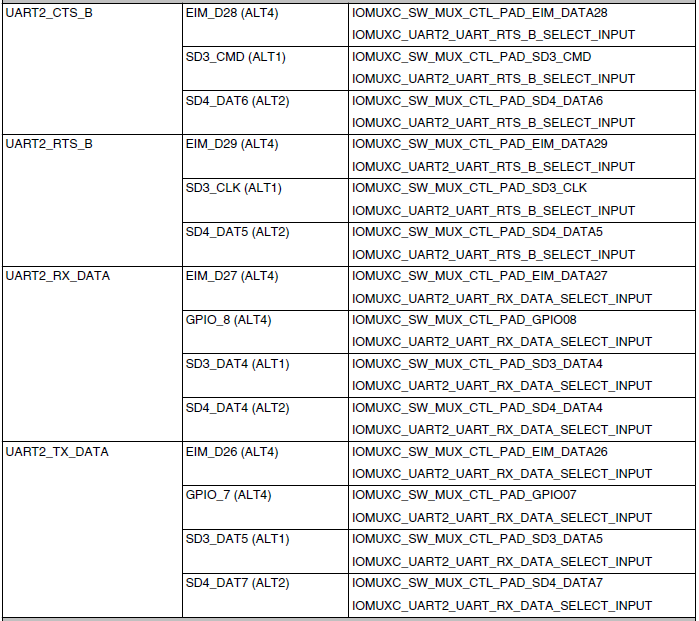

When I use the IOMux tool (Version 3.4.0.0) to generate the code to route the pins for UART2 on the i.MX6Q (pins E25/E26) it generates the following code:
void uart2_iomux_config(void)
    // Config uart2.UART2_RX_DATA to pad EIM_DATA27(E25)
    HW_IOMUXC_SW_MUX_CTL_PAD_EIM_DATA27_WR(0x00000004); // DISABLED, ALT4
    // ENABLED, 100K_OHM_PU, PULL, ENABLED, DISABLED, 100MHZ, 40_OHM, SLOW
    HW_IOMUXC_SW_PAD_CTL_PAD_EIM_DATA27_WR(0x0001B0B0);
    HW_IOMUXC_UART2_UART_RX_DATA_SELECT_INPUT_WR(0x00000000); // EIM_DATA26_ALT4
    // Config uart2.UART2_TX_DATA to pad EIM_DATA26(E24)
    HW_IOMUXC_SW_MUX_CTL_PAD_EIM_DATA26_WR(0x00000004); // DISABLED, ALT4
    HW_IOMUXC_SW_PAD_CTL_PAD_EIM_DATA26_WR(0x0001B0B0);
This works fine for writing to the port, but unless I add the following line:
HW_IOMUXC_UART2_UART_RX_DATA_SELECT_INPUT_WR(BF_IOMUXC_UART2_UART_RX_DATA_SELECT_INPUT_DAISY_V(EIM_DATA27_ALT4));
I can't read from the port - I don't get a signal on the RDR bit of USR2.  Adding the line fixes the problem - I can read and write to UART2.
Have I missed something here?  I've not tried it on the other UART - presumably I'll find similar problems?

Hello,Andrew,
      EIM_D25 can be iomuxed UART3_RX_DATA, not UART2_RX. But UART2_RX can be routed throuth EIM_D27 Pin. Please Check it in I.MX6QRM.pdf , PAGE 275.

I'm not sure how that helps.  I'm trying to get UART1 and UART2 to work, I'm not using UART3.  To get UART1 to work I need to add the line:
HW_IOMUXC_UART1_UART_RX_DATA_SELECT_INPUT_WR(BF_IOMUXC_UART1_UART_RX_DATA_SELECT_INPUT_DAISY_V(SD3_DATA6_ALT1));
This appears to be because the code that the IOMux tool produces incorrectly routes.  For example, IOMux tool produces the code:
HW_IOMUXC_UART2_UART_RX_DATA_SELECT_INPUT_WR(BF_IOMUXC_UART2_UART_RX_DATA_SELECT_INPUT_DAISY_V(EIM_DATA26_ALT4));
which routes UART2_TX_DATA. The code should read:
which routes UART2_RX_DATA.

weidong_sun
Hi, Norman,
    Actually, there serveral methords to iomux UART2 signals, could you understand this list ?
UART2_RX and UART2_TX can be routed out via 4 different PADs. I just gave you 3 PADs of them before.
Weidong
