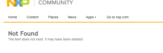

Hi Ruben,
Thanks for your reply.
I don't need decoding of part numbers.
I just need part marking details in the top of IC, this we need to verify IC during Visual inspection.
And also you shared link not showing any content for me.

nxf54947
Hi [email protected]‌,
Thank you for letting me know that the previous link didn´t work upon. I was trying to point you out to the part number nomenclature (Figure 1) contained on the i.MX 6 Solo X's Datasheet:
www.nxp.com/docs/en/data-sheet/IMX6SXIEC.pdf#page=5
Unfortunately, I am not allowed to share more details on the MCIMX6X4CVM08AC's part marking on this community. For that end, my suggestion is to open a support ticket (if needed, you can find a guide of this process below):
https://community.nxp.com/docs/DOC-329745
My apologies for the inconvenience caused.
Ruben
