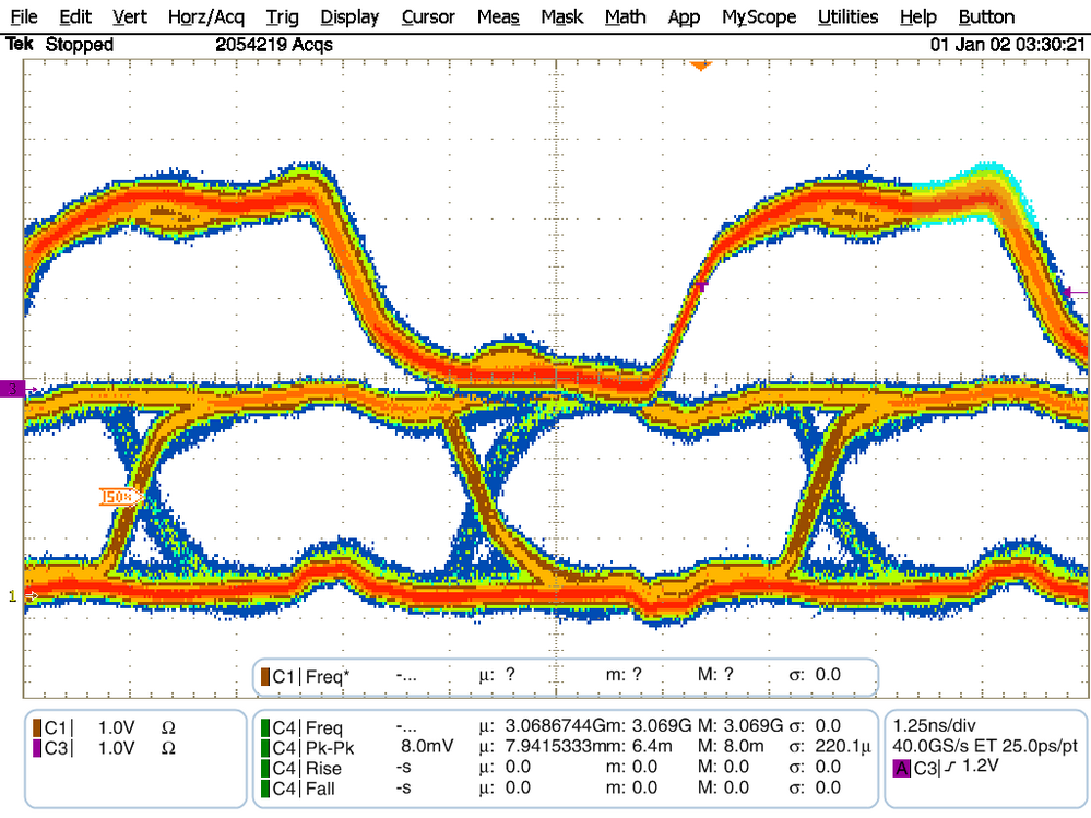

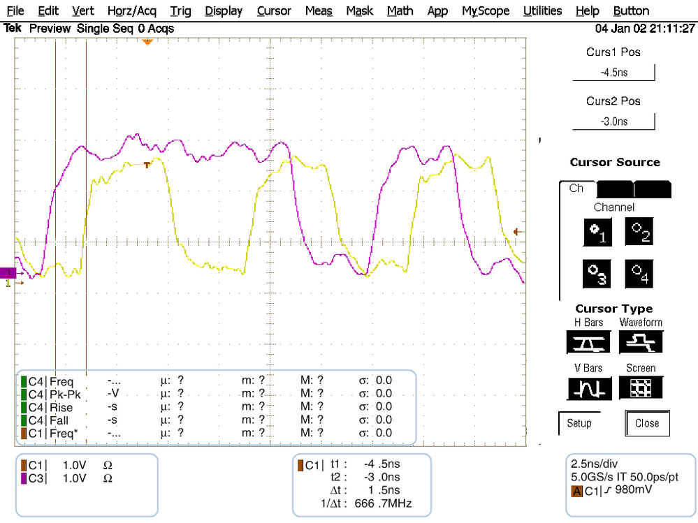

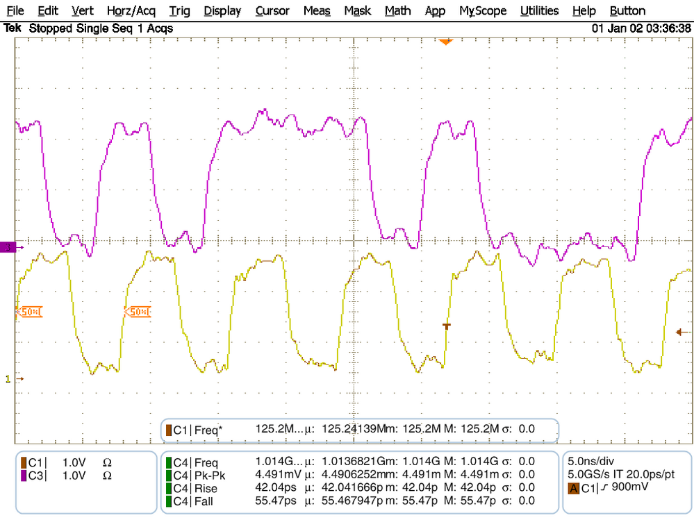

Dear Igor,
See below snapshots of
1. RGMII RXD0 RX CLK fall at IMX side
2. RGMII CLK RX DX0 1.5n raise at IMX side
3&4. rgmii clk rd0 at imx6 sides
These signals are output from Marvell Switch 88E6176 toward iMX receive port. Do you see any issues with this timings?
Waiting for your response!
Hitesh
RGMII_RXD0_RX-CLK_fall_at_IMX_side.bmpRGMII_CLK_RX_DX0_1.5n_raise_at_IMX_side.bmprgmii clk_rd0_at_imx6 side2.bmprgmii clk_rd0_at_imx6 side.bmp

igorpadykov
