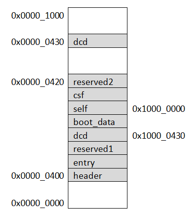

I have a generic question regarding i.MX6 IVT structure. I will refer to i.MX6 Platform SDK apps and u-boot binaries.
DCD section is used for setting up DDR memory both in SDK tests and in u-boot. DCD section itself is linked to DDR memory address space. Also if you look inside a binary you can find that ivt.dcd is pointing to DDR memory location:
# ./ivt_dump ./power_modes_test.bin
DCD: 0x10000430 (DDR)
# ./ivt_dump ./u-boot.bin
DCD: 0x2780042C (DDR)
So it looks like we should have DCD placed in DDR, but DDR is not yet initialized by DCD. I know that DCD should reside in initial load region and thus ti will be loaded to OCRAM. But how ROM will find the real DCD location based only on ivt.dcd, which is poiniting to non-initialized DDR?

Hi, Dmitry
     DCD table will be copied to OCRAM within the first 4K copy from SD/MMC. And the "dcd" and "self" will be used to count the "offset" of DCD table address, and ROM will read DCD table using this offset from OCRAM. For your case, the offset will be "0x10000430 - 0x10000000 = 0x430". I just dump my uboot, I can see the "dcd" is 0x2780042c, and "self" is 0x27800400, so the offset would be 0x2c = 44, which means the real dcd table is at the 44 / 4  + 1= 12nd data of the first 4K data(containing the IVT offset) copied to OCRAM, below is my ivt header definition, you can see the dcd table is at 12nd.  So, ROM will use these two value to count the offset, so there will be no DDR address accessed before DCD table is executed.

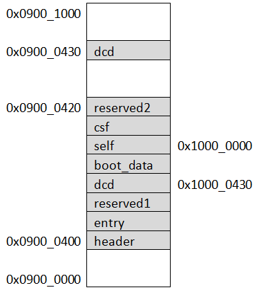

dmitryv
Hi Yongcai,
I understand the process of booting but I was asking another question. Let me explain in more details.
Here's the structure of boot stream (first 4K which will be loaded to OCRAM). On left side there are absolute addresses from the beginning of the file. On right side I placed values that are stored in this file.
Now when the boot ROM fetches the stream from boot source, the same 4K bytes are placed to some location in OCRAM (I will assume that they are placed from the beginning just for easy of understanding).
You can see that DCD physycal location is 0x0900_0430, but the pointer is pointing to location in DDR which is even not yet initialized.
I have an assumption that ROM will calculate the real address as ( dcd - self + OCRAM_BEGIN ) in this case.

Hi, Dmitry
