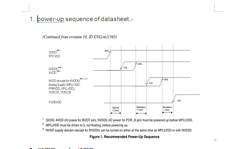

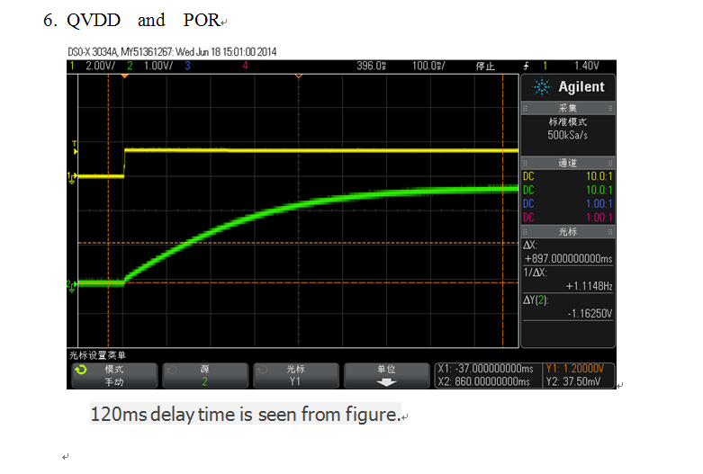

I passed the test found PLL did not work, no CLKO_PF15 400M processor output.
Our board power-up sequence is as follows。
1,782 Views
Yuri
As for power up sequence, according to ENGcm11563 erratum :
NVCC5 must be powered up before MPLLVDD. On Your waveforms NVCC5 (NVDD5) is not present,
but from the schematic this requirement is not met.
1,782 Views
任贵孙
Our power sequencing  comply ENGcm11563 erratum requirements. NVDD_5 and AVDD are 2.75V supply.6.bmp7.bmp
1,782 Views
Yuri
The power up sequence is correct.
But please pay attention on ENGcm12387, which takes place just for i.MX27 of new rev. 2.2.
Perhaps this is the reason why the first version of Your board was working, but new devices - do not.
Yuri

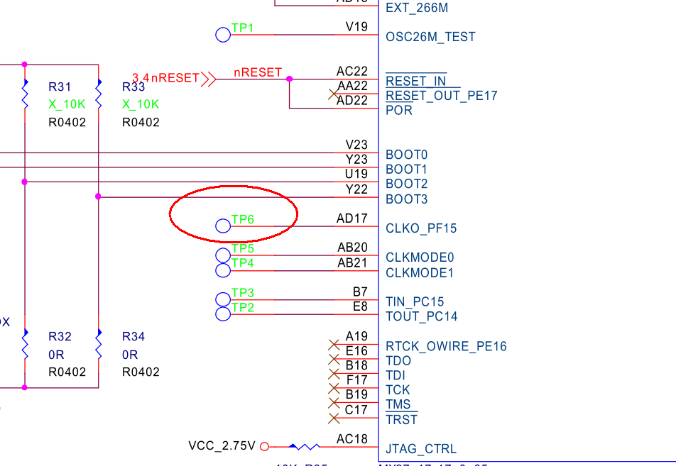

You wrote about not working PLL - how it was detected ?
Note, by default the CLKO provides 32 KHz.
Yuri
1,782 Views
任贵孙
1. When using the serial boot mode download boot, I can test to 32.768KHz square wave at the processor CLKO_PF15 pin .
2. I can  test to 400M sine wave  at the CLKO_PF15 pin from nand start in the first edition of the board, but  test to high in the second edition of the board.
3. We blocked the following program in the bootloader, the processor can boot from NAND, but the frequency is wrong, the system is not working properly.
    So I think the PLL is not working properly.
