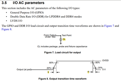

I looked for "ECSPIx_SCLK Rise or Fall" time in table 36 - which references to section 3.5 (I/O AC parameters).
In figure 8 I can find the necessary tr and tf markers. However, if you search within the document, there are no actual numbers listed anywhere in the datasheet. So what values do I have to expect here?
According to table 36 I would expect some minimum and/or maximum values, but I can't extract any of those from the datasheet. Can you please provide some information on that?

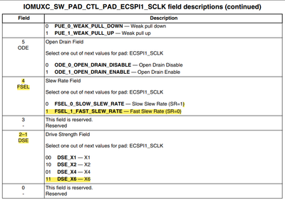

As it has indicated in the datasheet, the Tr and Tf value shall refer to Section 3.5.
According to Section 3.5 description shown below, the Tr and Tf depend on the load capacitance (CL) on the IO and its drive strength (output resistance).
According to the RC charge/discharge circuit and equation shown below, the rising and falling time between 20% and 80% OVDD is [Tr = Tf = 1.39RC], where R is the output resistance and C is the load capacitance (CL).

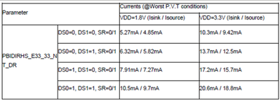

According to the Drive Strength setting and its corresponding output current table shown below, the minimum output resistance of the IO at Fast slew rate mode is around [(1.8V / 10.5mA + 3.3V / 20.6mA) / 2 = 165Ohms] and the maximum output resistance of the IO at Fast slew rate mode is around [(1.8V / 5.27mA + 3.3V / 10.3mA) / 2 = 330Ohms].
Suppose the load capacitance is 50pF, the minimum Tr and Tf would be [Tr = Tf = 1.39 x 165Ohms x 50pF = 11.5ns] and the maximum Tr and Tf would be [Tr = Tf = 1.39 x 330Ohms x 50pF = 23ns].
