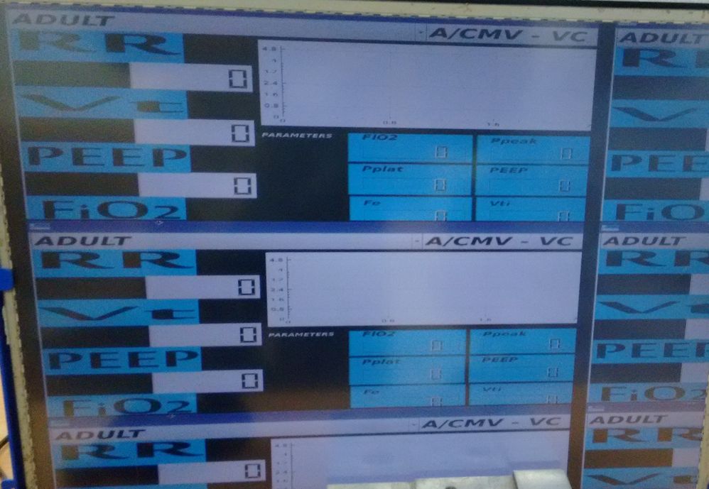

I am using Imx 6 pico sbc with linux 3.035. i have interfaced my board with LVDS. but i am getting the screen as attached below.
screens are splitted in to 6 views
please get me some solution to solve this.

What is the resolution of your screen and what is the resolution of your framebuffer?
Does it match?
if not can you try the fbset command, for instance:
fbset -fb /dev/fb0 -g 1024 768 1024 2304 32
check resolution, fb number and bpp.
check also fbset manual:
fbset - Linux Command - Unix Command
V.

i have rectified this error, by changing the display standard.
