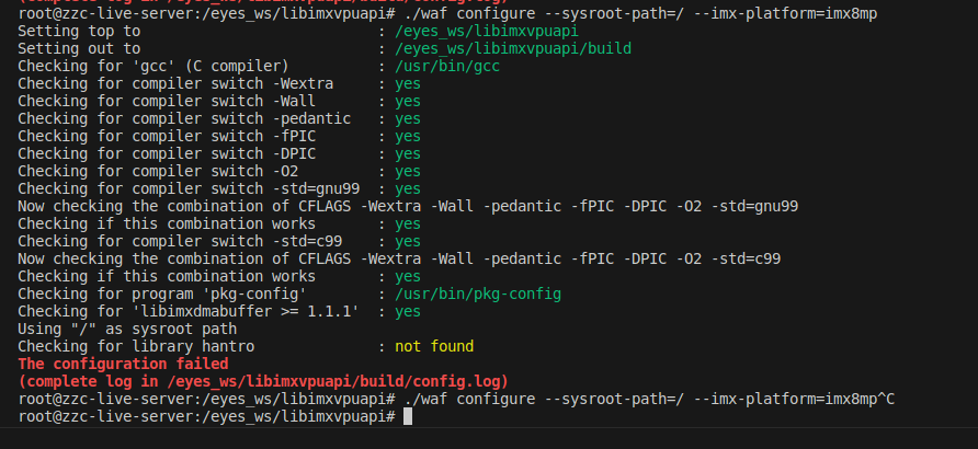

Hello, I am using imx8mp now. instead of using yocoto, I have install a ubuntu  file system on the board. but now i'd like using opencv2 gstreamer plugin to get rtsp video to handle it. but now I can't using hard decode plugin which result in a more than one secode frame delay . wonder how to build and install it on the board directly? Thanks.

thanks for your quck reply. I has try build this lib, but can't build it. how to get `hantro`? thanks!

One can check the available library from the command 'ldconfig -p | grep <lib_name>'.
Please check if you were able to find the libhantro.so and libcodec.so under /usr/lib? they are a hantro library.
Q)how to get `hantro`?
=> To get Hantro packages, one needs to add below 2 lines in the $BUILD/conf/local.conf file.
IMAGE_INSTALL_append = " imx-vpu-hantro"
IMAGE_INSTALL_append = " imx-vpu-hantro-vc"
The more information related to Hantro, kindly refer to section 6.7 Video Processing Unit (VPU) from the i.MX Linux Reference Manual.
