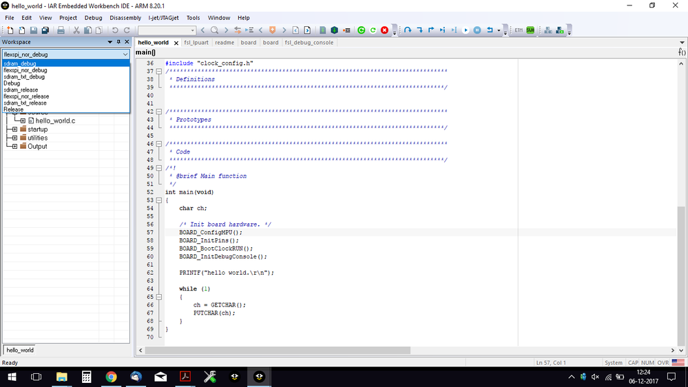

1. As you said In the above mail I have gone through PDF file, I have following debug files in my Hello world program
   1. sdram_debug
   2. flexspi_nor_debug
   3. sdram_txt_debug
   4. debug
there is no hyper_debug in above options.and I did't find  any MIMXRT1052xxx6A_hyper.icf  in the downloaded programs.

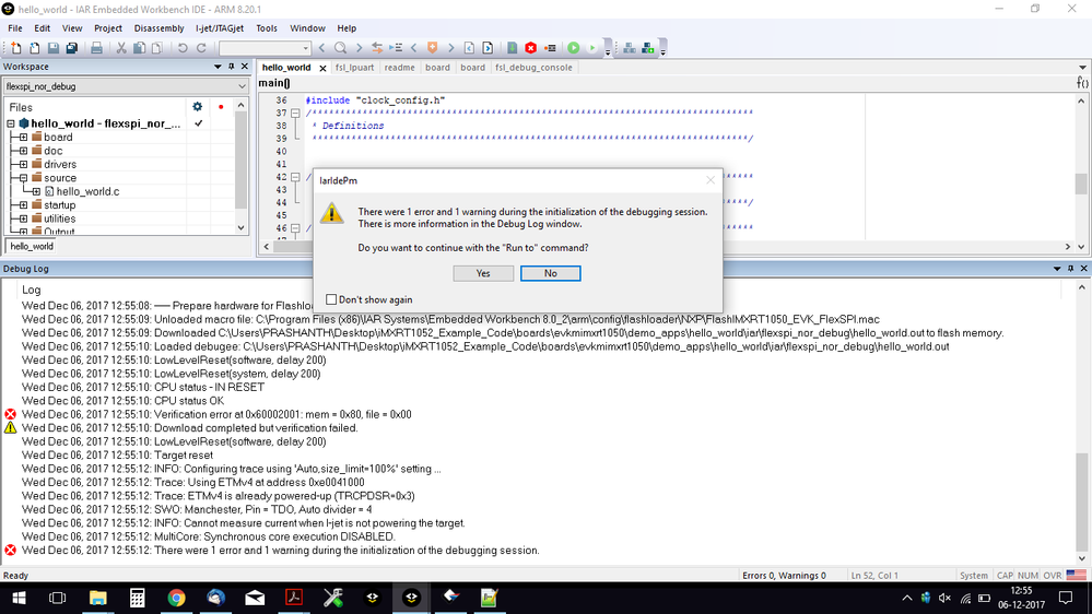

2. When I select  flexspi_nor_debug, It is showing following error.
" Verification Error  0x60002001 : mem = 0x80, file  = 0x00"
3, When I try modify icf file  with configurations as you said PDF file it is showing as above same error

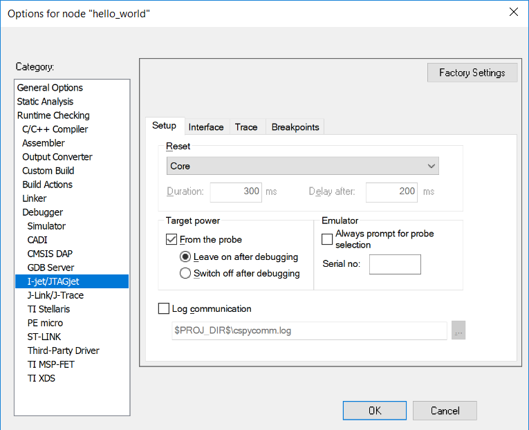

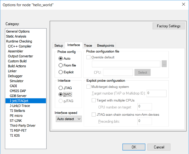

The issue you are seeing with Verify errors may be related to the Reset type used by the debugger. It seems you are using I-Jet. I would suggest modifying the Reset type in the debug options to "Core" type. Also, make sure the interface is set to SWD, not JTAG.
Project > Options > I-jet/JTAGjet > Setup
Project > Options > I-jet/JTAGjet > Interface

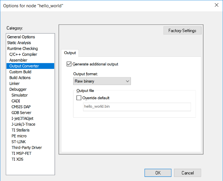

Currently, the hello_world project for IAR does not include the IVT, boot data needed to create a bootable image to run out of reset. You can use the drag/drop feature described in the HyperFlashprog_MXRT1050.pdf to create and program an image into the Hyperflash that will execute after a power off/on. (Just note, it's using the flexspi_nor_debug instead of the hyper_debug. It looks like that guide is out of date). Here is some additional information about the drag/drop:
i.MX RT1050 CMSIS-DAP drag-and-drop programming
Also, you will need to generate a .bin output from the compile step which can be specified in
Project > Options > Output Converter
Check the "Generate additional Output"
Select "Raw Binary"

When I select  flexspi_nor_debug, before debugging start it creates following error:
" Verification Error at 0x60002001 : mem = 0x80, file  = 0x00"
" Download completed but verification failed."
