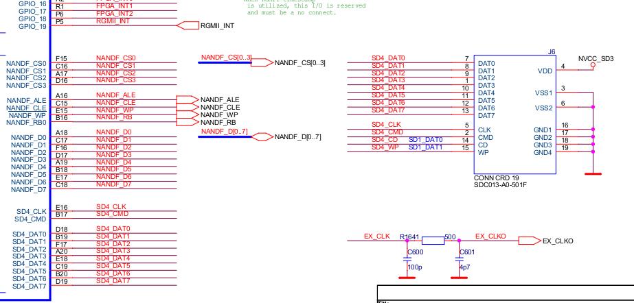

In my board only have sd4 look at pg1

the code such as :
configs file :
#define CONFIG_FSL_ESDHC
#define CONFIG_FSL_USDHC
#define CONFIG_SYS_FSL_ESDHC_ADDR      USDHC4_BASE_ADDR
#define CONFIG_MMCROOT   "/dev/mmcblk3p2"  /* SDHC4 */
#define CONFIG_SYS_FSL_USDHC_NUM    3
#define CONFIG_SYS_MMC_ENV_DEV   2  /* SDHC4 */
#define CONFIG_SYS_MMC_ENV_PART            0   /* user partition */
borad .c

build  u-boot.imx   ,but  i can not find sd4,as :
U-Boot 2015.04-14468-gd7d7c43-dirty (Jun 22 2016 - 15:02:33)
CPU:   Freescale i.MX6Q rev1.5 at 792 MHz
CPU:   Temperature 38 C
Reset cause: POR
Board: MX6Q-Sabreauto revA
I2C:   ready
DRAM:  1 GiB
PMIC:  PFUZE100 ID=0x10
MMC:   Warning: you configured more USDHC controllers(1) then supported by the board (3)
FSL_SDHC: 0
MMC Device 2 not found
No MMC card found
Using default environment
In:    serial
Out:   serial
Err:   serial
no mmc device at slot 2
Net:   FEC [PRIME]
Error: FEC address not set.
Boot from USB for mfgtools
Use default environment for                              mfgtools
Run bootcmd_mfg: run mfgtool_args;bootz ${loadaddr} ${initrd_addr} ${fdt_addr};
Hit any key to stop autoboot:  0
Bad Linux ARM zImage magic!

Hi xuhui
please refer to attached Porting Guide
Chapter 4 Adding Support for SDHC
Also SD4 is supported for SabreSD board (emmc) and
one can look at uboot sources in
uboot-imx.git - Freescale i.MX u-boot Tree
igor
2,918 Views
lixuhui112
yes I look the Porting Guide and you can look my code ,it is Modified in accordance with mx6sabresd.c ,but it is not ok
