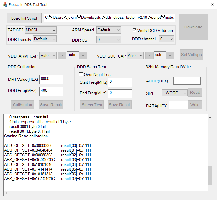

I have been trying to test calibration DDR2 on a DDR Test Tool with attached reference script file.
  • tool : ddr_stress_tester_v2.40
  • script : MX6SL_EVK_LPDDR2_512MB_32bit_v0.9.inc
But when I run DDR calibration, failed during ddr calibration on pc program.
Problem are as the below.
Message is "Error: failed during ddr calibration"

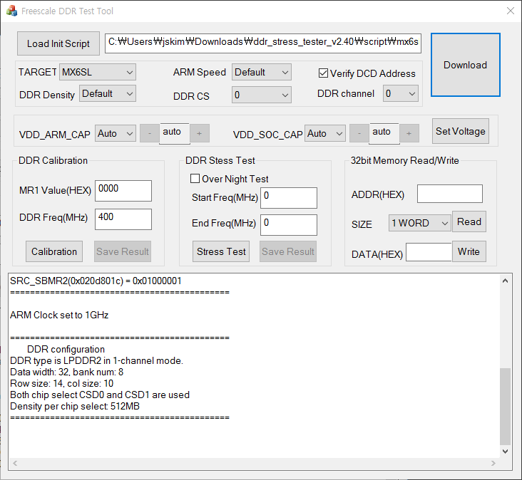

        DDR configuration
DDR type is LPDDR2 in 1-channel mode.
Data width: 32, bank num: 8
Row size: 14, col size: 10
Both chip select CSD0 and CSD1 are used
Density per chip select: 512MB

Starting Read calibration...
ABS_OFFSET=0x00000000 result[00]=0x1111
ABS_OFFSET=0x04040404 result[01]=0x1111
ABS_OFFSET=0x08080808 result[02]=0x1111
ABS_OFFSET=0x0C0C0C0C result[03]=0x1111

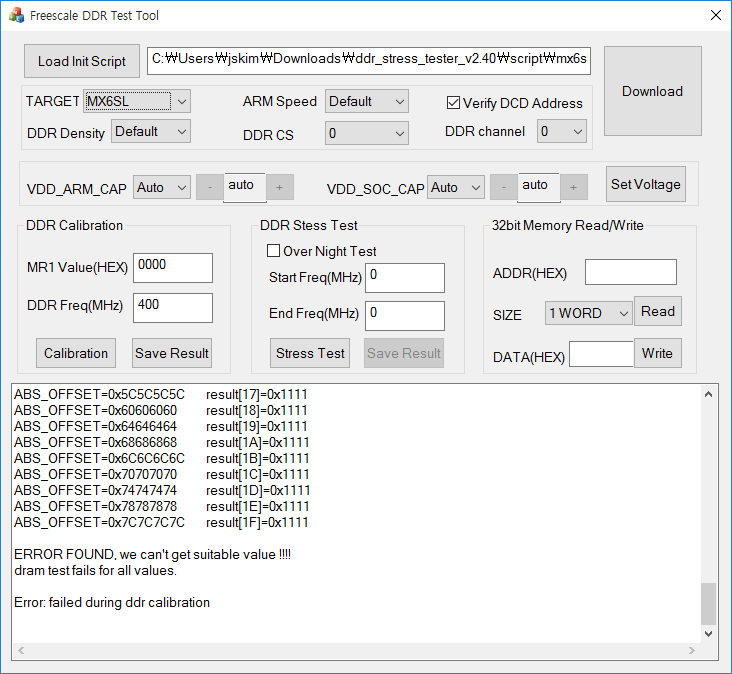

ERROR FOUND, we can't get suitable value !!!!
dram test fails for all values.
We don't know what's the problem.
Please, give us some checking point.

igorpadykov
Hi Junsil
one can try to enter "MR1" value in GUI, one can find it
from MX6SL_EVK_LPDDR2_512MB_32bit_v0.9.inc.zip:
// LPDDR2 Mode Register Writes
setmem /32    0x021b001c =0x82018030     // MRW: BA=0 CS=0 MR_ADDR=1  MR_OP=see Register Configuration
MR1=0x82
Also it makes sense to test with 1.03 version of ddr test
https://community.freescale.com/docs/DOC-96412
1. it is the same part
2. please recheck ddr connections, testing signals with oscillosope
It makes sense to attach jtag and try read/write on single address.
