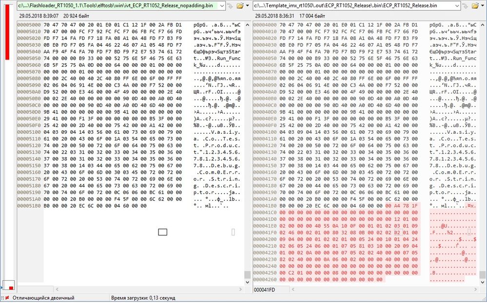

Good afternoon. It is not possible to add the IVT header for the axf file, the final file is then clipped.
Input parameters:
scf - file:
#! armcc -E
#define m_interrupts_start 0x00002000
#define m_interrupts_size 0x00000400
#define m_text_start m_interrupts_start + m_interrupts_size
#define m_text_size 0x00020000 - m_interrupts_size
#define m_data_start 0x20000000
#define m_data_size 0x00020000
/* Sizes */
#if (defined(__stack_size__))
#define Stack_Size __stack_size__
#else
#define Stack_Size 0x0400
#endif
#if (defined(__heap_size__))
#define Heap_Size __heap_size__
#else
#define Heap_Size 0x0400
#endif
LR_m_text m_interrupts_start m_text_start+m_text_size-m_interrupts_size { ; load region size_region
VECTOR_ROM m_interrupts_start m_interrupts_size { ; load address = execution address
* (RESET,+FIRST)
ER_m_text m_text_start m_text_size { ; load address = execution address
* (InRoot$$Sections)
.ANY (+RO)
RW_m_data m_data_start m_data_size-Stack_Size-Heap_Size { ; RW data
.ANY (+RW +ZI)
* (NonCacheable.init)
* (NonCacheable)
ARM_LIB_HEAP +0 EMPTY Heap_Size { ; Heap region growing up
ARM_LIB_STACK m_data_start+m_data_size EMPTY -Stack_Size { ; Stack region growing down
imx-itcm-unsigned.bd:
options {
flags = 0x00;
startAddress = 0x0000;
ivtOffset = 0x00001000;
initialLoadSize = 0x00002000;
entryPointAddress = 0x00002000;
DCDFilePath = "dcd.bin";
sources {
elfFile = extern(0);
section (0)
Run elftosb:
elftosb.exe -d -f imx -V -c imx-itcm-unsigned.bd -o ivt_ECP_RT1052_Release.bin ECP_RT1052_Release.axf
The elftosb utility is very unstable, constantly crashes.
For example, the following situation leads to departure:
.ANY (+RW +ZI)
.ANY (+RO)
* (NonCacheable)
Tell me how to properly process the elf file?
