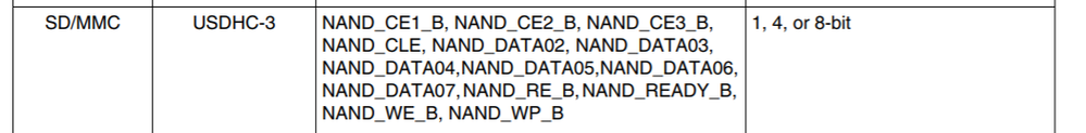

We are using i.MX8M Mini Quad core processor in our device. We have connected eMMC 8GB/16GB on NAND as per attached image. eMMC part# is MTFC8GAKAJCN-1M WT (8GB)/MTFC16GAPALBH-IT  (16GB).
We have connected our WiFi module on SD1 port and SD2 port is used as GPIO.
Please confirm whether we can connect eMMC on NAND port or not as shown in attached image.
Please respond on this ASAP. eMMC datasheet is also attached.

Yes it shouldn't have a problem, please refer to i.MX 8MM datasheet section 4.2 Boot device interface allocation:
Also, for a new design you can always take a look to our EVK schematic and layout for reference:
https://www.nxp.com/webapp/Download?colCode=8MMINILPD4-EVK-DESIGNFILES
