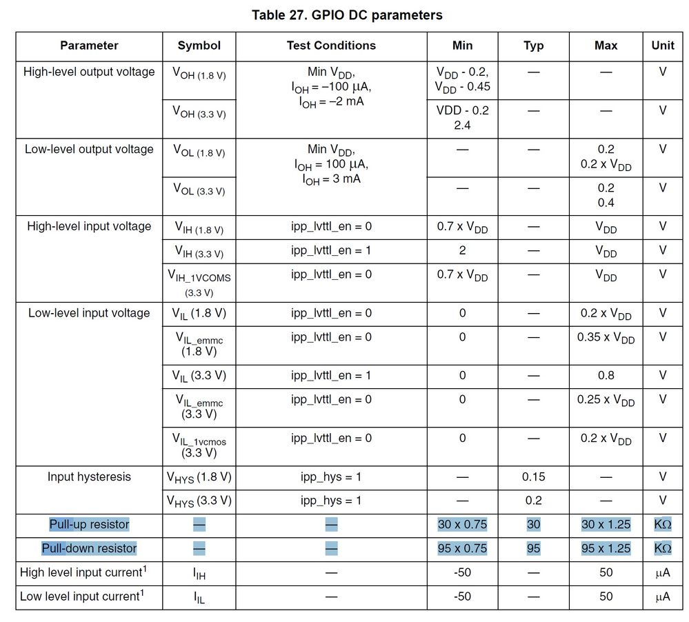

Does the eMMC Host Controller in iMX8M operates in push-pull mode?
Is the value of the push-pull resistors according to the pull-up/down resistors shows in Table 27? Thanks.

Please refer to the reference design.

I did not find any info from the reference design or user's guide that mention if the configuration of the eMMC controller in the EVK board is set to push-pull or not. Could you advise where I can get the info?
Thanks.
