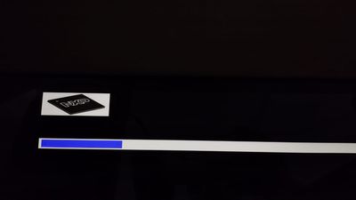

Dear Team,
Platform: iMX8QM MEK
Software: Android-11 Automotive OS
Number of display : 2 ports LVDS0 & LVDS1
As soon as I switch the board on,  NXP logo and progress bar is show like below in the display connected to LVDS-1.
I basically want to disable display driver for LVDS-1 at U-boot stage and on need only to be turned up after Android boot complete. Right now the behaviour is that during U-Boot NXP logo and progress is shown, then display is off and then turned after Android boot compelte.
Please help me disable LVDS-1 @ SPL & U-boot stage. It is very urgent.

vinothkumars
Senior Contributor IV
It is define here,
vendor/nxp/mcu-sdk-auto/SDK_MEK-MIMX8QM/boards/mekmimx8qm/demo_apps/rear_view_camera/cm4_core1/isi_config.h
* For QM RVC, It is required that LVDS1 is used when select LVDS display interface
* DPU1 should be used to accomodate this. Comment it out if use MIPI display interface
#define USE_LVDS1

vinothkumars
Hi @Jose1985 ,
You have to disable in M4 Source Code.
