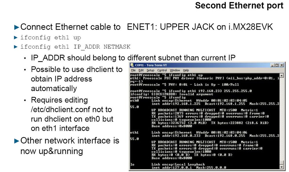

Hi Mingyang
one can try second fec using procedure described below for i.MX28 EVK and L2.6.35
Submit i.MX53 &amp; i.MX28 Linux kernel patches
