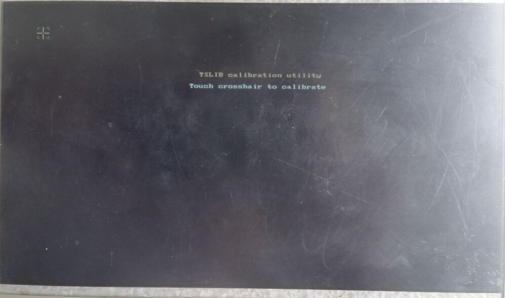

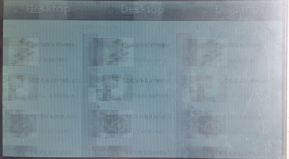

Hello,Community:
I am now working on Freescale  imx6q   connected a 7" 800 x 480 LCD display and touch with tsc2007, i change the file .dtis .
if i use a  mouse the display is ok ,the touch can work but not the correct position.  but if i run the ts_calibrate int /usr/bin  first i can calibrate the touch panel,but after ts_calibrate quit the lcd has a wrong display, the command cat .bmp bf0 also display wrong ,but if i run ts_calibrate or ts_test,the lcd is ok.

Are you using LCD in "rotated" mode?
Please try to play with xrandr prior to ts_calibrate.

thankyou for your answer, my lcd was not in "rotated" mode.you can see my pictures of the screen. when i run ts_calibrate the screen will be ok again
