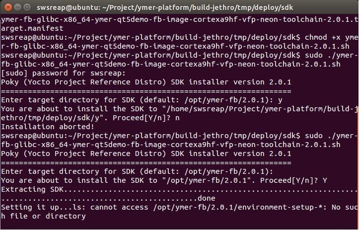

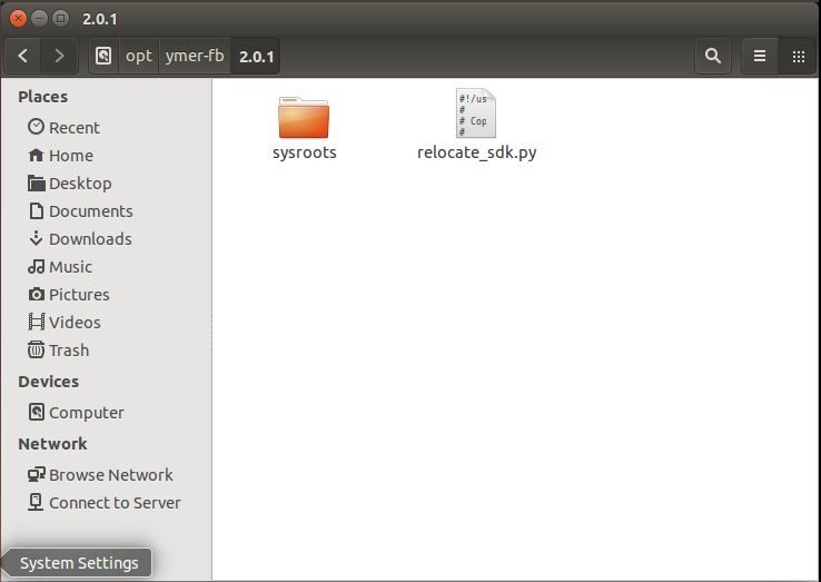

Firstly I have built a sdk for yocto. when I running the install script, it can't set it up. But this sdk can be install sucessfully in my European colleague's computer. Do I miss something to set up my system? Thank you!

From the log I see that installation script unpacks /opt/ymer-fb/2.0.1 and than something inside is missing.
So first please check if you have enough disk space.

I think the disk space is enough. I have uploaded the sdk to the cloud driver: http://pan.baidu.com/s/1c24xBcW

below is the disk information.
ming@ming-VirtualBox:~$ df -h
Filesystem Size Used Avail Use% Mounted on
udev 487M 4.0K 486M 1% /dev
tmpfs 100M 944K 99M 1% /run
/dev/sda1 177G 19G 149G 11% /
none 4.0K 0 4.0K 0% /sys/fs/cgroup
none 5.0M 0 5.0M 0% /run/lock
none 497M 152K 497M 1% /run/shm
none 100M 56K 100M 1% /run/user
