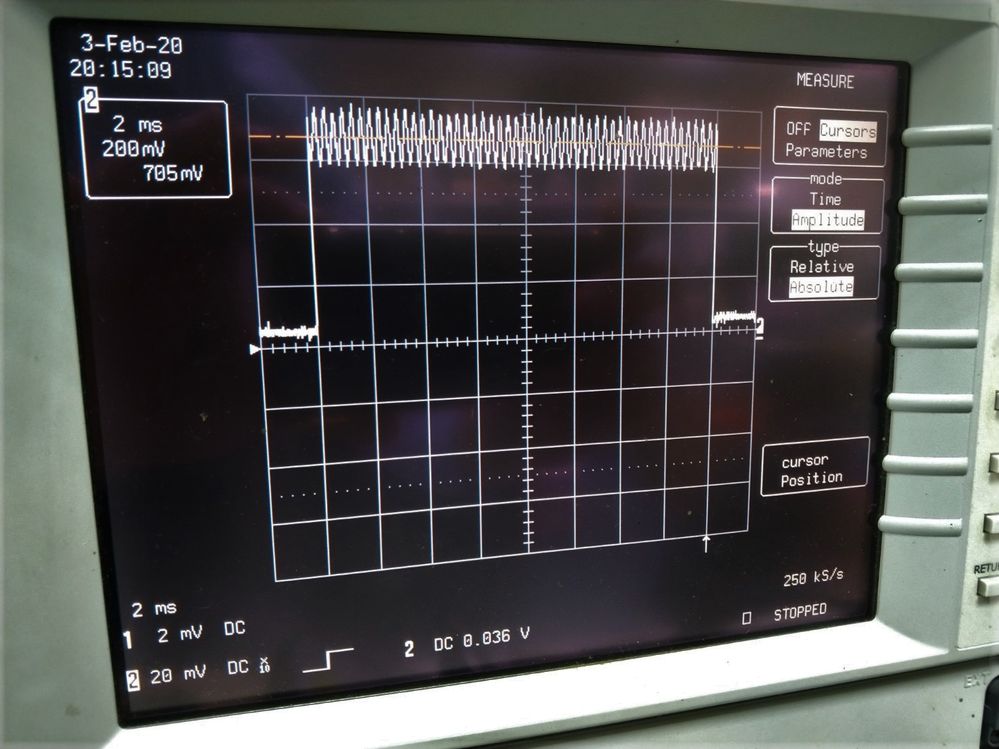

Hi all,
I measured some pin with oscilloscope showed as follow:
DRAM_SDCKE0= 0V
DRAM_SDCKE1=   0V,when doing calibration it came to 1.37V for about 16ms.
DRAM_VREF=        0.68V
DRAM_1V35=         1.37V
DRAM_RESET_B= 0V
XTALI=                    22.5MHz
RTCXTALI=             33.3kHz
DRAM_RESET_B was always be 0V when downloading script or doing calibration.
If I am not misunderstanding,according to Hardware Development Guide for the i.MX 6UltraLite Applications Processor ,
DRAM_RESET_B should go High when board getting calibration.
I'll keep finding how the bug comes up.
If someone know how to deal with it,leave some comment,please.
Thanks.

kr90911
Hi,igor
Thank for your response.
I captured a signal showed as followed when ddr test tool doing calibration.
The signal from DRAM SD_CLK0P:
The signal from SDQS0P and SDQS1P:
I think calibration failed because delay time of SDQS1 as log showed before.
Is there any possible way to fix delay time of SDQS1?
Thanks and best regards.

kr90911
Hi,igor.
Thanks for your support.
I found some detail about this issue.
I hope you can look at this.
Thanks.
