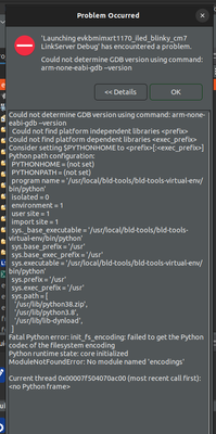

Hello, I am using MCUXpresso and I.MX RT1176 EVK on ubuntu 22.04. I want to debug a hello_world sdk project. Build operation is OK but when i try to debug i get this error:
How can i solve this problem?

I deleted the IDE and reinstalled it and it worked.

 Look like the error is not gdb, is python please install correctly on your host.
