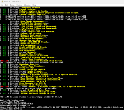

I purchased FRDM-imx91 board. Board was able to boot from eMMC (out of box image) and I can see scripts on terminal, when I try to login as a 'root' terminal does not accept any input from my keyboard. Attached screenshot of terminal.
Host- Ubuntu 22.04

Hey Chavira,
HW flow control was off, it solved. Please close the case.

HI @onky!
Thank you for contacting NXP Support!
I am not able to test now in Linux Host machine, but using windows 11 with teraterm I am not having any issue.
Can you try using screen instead of minicom?
If it is possible try using windows machine too, to discard any malfunction of the baord.
If the problem persists in other machine , please let me know.
