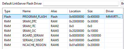

Initializing a struct in SDRAM and then reading the values when the application runs, does not return the same values as initially set.
The struct is defined as:
typedef struct _cf_full_t {
uint8_t cf_bnb[160+40+50];
uint16_t cf_word[10];
uint32_t cf_dword[10];
} cf_full_t;
The  global variable of this struct type is initialized as:
__DATA(RAM5) const cf_full_t cf_default =  // have tried with and w/o const
0, 1, 1, 0, 0, 0, 0, 0, 0, 0, // 0 - 9
1, 1, 1, 1, 1, 1, 1, 1, 0, 1, // 10 - 19
3, 0, 0, 0, 4, 0, 0, 0, 0, 0, // 190 - 199
3, 1, 25, 8, 40, 0, 65, 4, 65, 25, // 200 - 209
5, 5, 2, 1, 75, 1, 40, 20, 40, 50, // 210 - 219
2, 5, 50, 6, 4, 30, 30, 14, 30, 25, // 240 - 249
1571,2050,12200,0, 0,300, 10, 4, 40, 0, // 250 - 259
0, 0, 4, 140, 0, 0, 0, 0, 0, 0 // 260 - 269
Memory definition for i.MX RT1024
Does SDRAM need to specified in linker script as well? (tried it but it didn't help). SRAM blocks are additionally specified in ResetISR.
When reading the struct variable the first 200 bytes are rubbish, but from then on everything is correct.! (i.e. the last 50 bytes in cf_bnb as well as cf_word and cf_dword.
Any explanation or just a guide to using SDRAM will be highly appreciated. I have read the User Guide at found the __DATA, __BBS, __NOINIT keywords. Is that all there is to it?

I am confused about the read/write function used in the semc-demo. They work with address and data size specification just as when accessing data on an EEPROM. But if I place a global variable in a SDRAM memory section with the __DATA(RAM5) directive, can't I access this variable as any other variable?
Do I need to setup anything regarding SDRAM in linker scripts?
I tried in my own application to execute the BOARD_InitSEMC copied from the demo. Now all bytes in the arrays are 0 (zero) when read.
Yes, you can use __DATA(RAM5) directive to save variables in SDRAM, but please take in mind the SDRAM needs to be initialized. Or you can use the method of the example.
Only add the SDRAM section in the memory map, as you made in the next image:
