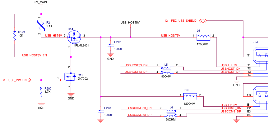

Q2. usb still have problm
USB_H1_VDDA33 & VDDA25 & USB_OTG_VDDA33 & VDDA25 are all correct. OTG is designed as dual role.
The problem is if I set USB_PWREN high level in static void __init mxc_board_init(void) function in bsp file,
the stage of start kernel will stop at mx5_usbh1_init() , and CPU seems shut down, the FAULT led light.
I really don't know how to solve it, it is weird.
Any reply will be appreciated.

     According to above debug, we can confirm the issue was caused by USB_PWREN & Q15, Now in order to ensure your design to be valueable for product, Can you continue do a test ?
(1)Restore Q15 to the board.
(2)Change R200(4.7K) to 0.1uF capacitor.(Replace R200 with 0.1uF capacitor)
In BSP, pull USB_PWREN up to high . Then tell me test result !
Weidong

USB_H1 is designed to HOST and OTG is designed to dual role.So the voltage of USB_H1_VBUS would be 5V when initialize the board. The function mx5_usbh1_init() has no code to set  USB_PWREN as 1, so we must initialize USB_PWREN in mx53_xx_io_init(),which is in bsp file,and set USB_PWREN as 1 to ensure  USB_H1_VBUS voltage will be 5V.Then we initialize USB_H1 by mx5_usbh1_init().The problem is if I do that the cpu will be shut down, the FAULT led light. If I delete the function to set USB_PWREN,which is mx5_set_host1_vubs_func() in my bsp file, there is no error when start kernel,but the voltage of USB_H1_VBUS is not correct obviously.Please refer my bsp file.

I removed the R186, error occured again.The USB_PWREN is 1.07V when board power is on,then drops to 0V.

I find a strange phenomenon. If I reset board immediately after error occured, the stage of usb initialization will pass.
The USB_PWREN is 1.07V when board power is on,then drops to 0V,then the voltage of USB_PWREN changed to be 3.3V.It can be held.

(1) add R186 on board.
(2)remove Q15 (2N7002) ,Then shorted it's pin2 and pin3.
     Keep USB_PWREN High in your program. Then re-boot your board, and tell me result !
Weidong
4,312 Views
caohaifeng
Hi,Weidong,
I have modified hardware and software.It seems that there is no error any more.
The voltage of USB_PWREN is 1.07V when power on,then it adjust to 3.2V.
Actually the process of start kernel is successful even I did not modify the USB_PWREN in program.
Haifeng

weidong_sun
Hello,Haifeng,
Weidong
4,312 Views
caohaifeng
Hi,Weidong,
I have modified hardware and software according with your suggestion.
(3)In BSP, pull USB_PWREN up to high when power on.
It works.
