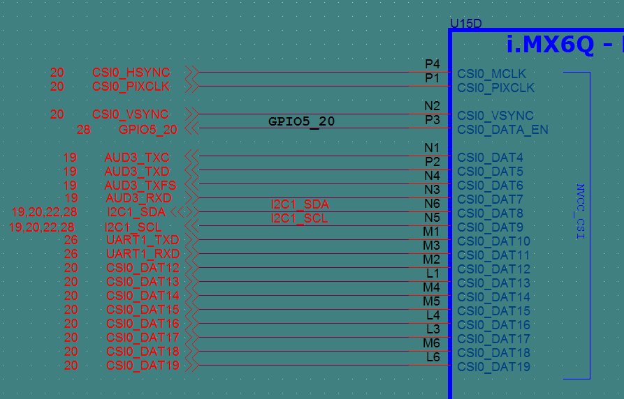

I'd like to drive the CSI inputs from a DSI (Display Serial Interface: in effect, serialized BT.565) signal source, but from what I can see, the serial camera inputs only accept proprietary signal standards such as MIPI. Will DSI work, or alternatively, are there any other public serial data standards which CSI can accept?
Regards & TIA
2,386件の閲覧回数
weidong_sun
Hello,David,
      There are 3 kinds of camera interface:
(1)CS0 port (parallel interface)
(2)CS1 port (parallel interface)
(3)MIPI port (serial interface)
     In addition, DSI port is display output . Not camera signal input .
Weidong

Many thanks, Weidong.
Those picture make it all clear.
