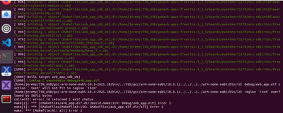

I am trying to build Eval IMMXRT1176 Ethernet AVB demo as build_debug.sh and I get the following error: `itcm' overflowed by 55880 bytes.  See attached log.  What can I do to fix this issue.  I do need the debug version.  See attached NXP instruction manual on how to duplicate the environment.

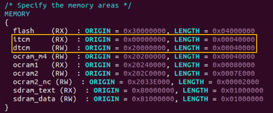

After digging deeper, I work it out finially and please modify the linker file (~\genavb-apps-freertos-3_3_5\boards\evkmimxrt1170\demo_apps\avb_tsn\common\armgcc\MIMXRT1176xxxxx_cm7.ld) as the below figure shows.
TIC

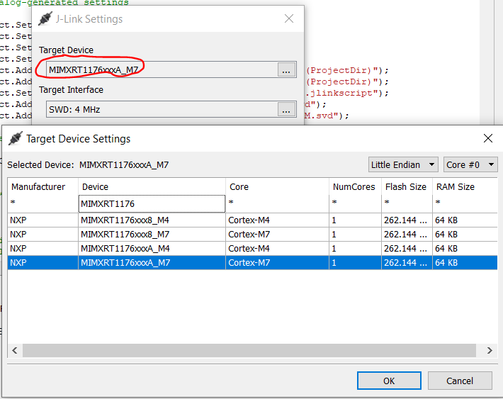

Note( I am using the Jlink-v7.60b, and the Ozone v3.10g, to make sure there are no errors on the version, please re-configure the project before debugging the code):
1. Select the chips by clicking tools->J-Link Settings, then select our chip, mine is MIMXRT1176xxxA_M7:
crist_xu_0-1647943023902.pngcrist_xu_0-1647943023902.pngcrist_xu_1-1647943083341.pngcrist_xu_1-1647943083341.png

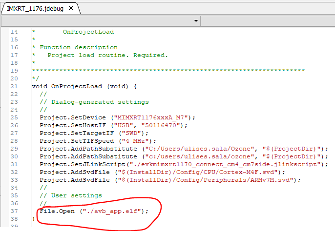

2. Edit the IMXRT_1176.jdebug, and change the elf file to your path:

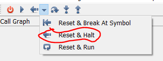

3. change the reset-type to Reset & Halt
We can debug our code then.
