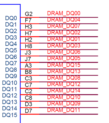

We are about to design our custom iMX8M Plus based CPU board. We will use the same DDR4 memory (MT40A512M16LY-062E) as in the reference design of iMX8M Mini EVK (8MMINID4-EVK) but with half of capacity (8Gb or 1GB).
In the mentioned reference design, there seems to be bit-swapping of data lines between the DDRAM and the iMX8M Mini  :

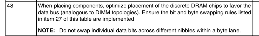

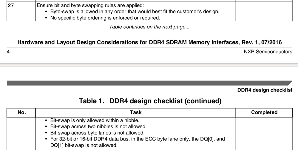

We also need to apply certain bit swapping to optimize the PCB layout and our own bit swapping would be different from above reference design. Therefore, I would like to know where to find the rules of DDR data bit/byte swapping applied for iMX8M Plus, please ? I found following article and application note (AN5097) which seem to be relevant : https://community.nxp.com/t5/Layerscape/AN5097-DDR4-Layout-Checklist-Clarification-for-LS1028A/td-p/...
AN5097 :
I would like to know if above rules should also be applied for the iMX8M Plus ?

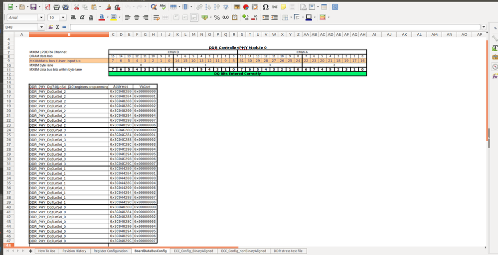

Hi again, CC : @weidong_sun ,
I found the following discussion in which you said  :
For DDR4, there is no restriction on the exchange of data bits, as you can see in this design files.
How can I interpret above statement correctly (i.e how can I configure this swapping correctly), please ? Seeing that there's no explicit BoardDataBusConfig tab in the MX8M_Plus_DDR4_RPA_v5.xlsx, but in MX8M_Plus_LPDDR4_RPA_v7.xlsx as below :
Thanks and best regards,
