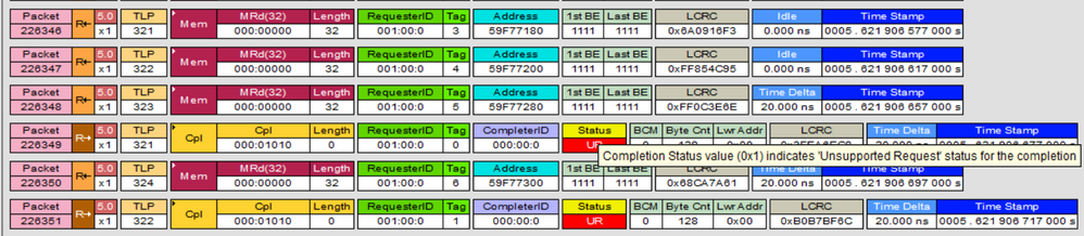

We’re doing DMA transfer using a custom PCIe device on iMX8M-EVK. When the PCIe device tries to read host memory, a ‘Unsupported Request’ status is obtained for the completion. This error is observed on linux kernel versions 5.4 and 5.10. We haven’t seen this issue on linux 4.19 kernel.
The inbound address that we are seeing on TLP packet is 0x59F77180.

As seen above, all the iATU registers in PCIe register map is read as 0xffffffff. Are we reading the correct offset? Does the 0x80000000 offset from PCIe base address gives correct physical address of inbound window registers?
How I can verify if the PCIe inbound window registers are configured correctly?
