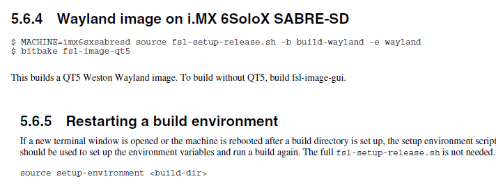

当我要编译image的时候,出现commnd not found。但我上次编译的时候却没有这个问题。

Hi stevenzhang
I found solution for your issue.
Do the following steps:
=> fsl-release-bsp$ source  setup-environment build-wayland
** Then it will automatically goes to build-wayland directory
=> build-wayland$ bitbake fsl-image-gui
Then now it's working properly.

BiyongSUN
then bitbake
Freescale_Yocto_Project_User's_Guide.pdf
