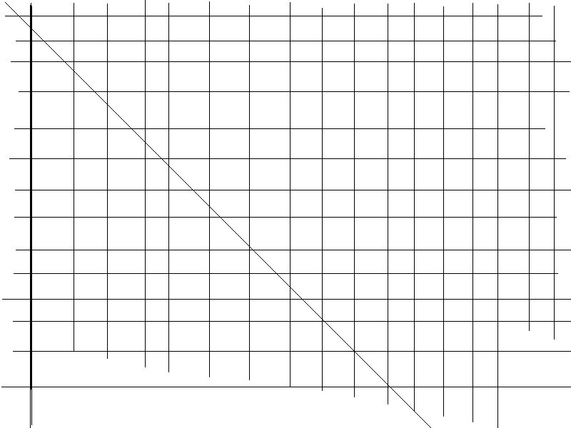

Since imx6q caputure all data including vaild data and invaild data. I programme to choose the vaild data and find that imx6q does not capture valid data in correct timing.Here is the image that imx6q captured:

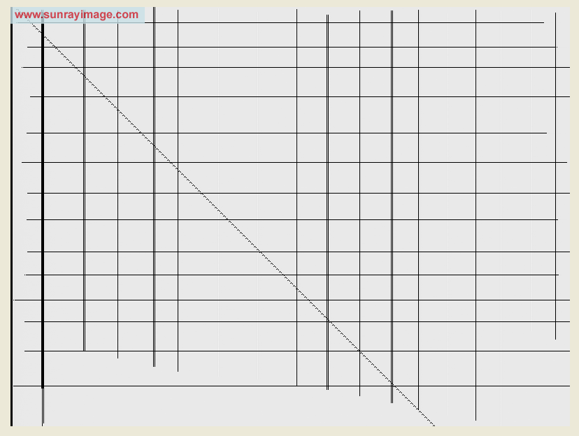

while the input image is like this:

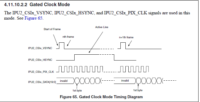

     Whatever, in my case, i.mx6 would receive 16bits 4:2:2 YUV signal while working in gated clock mode.I had used an oscilloscope to measure Hsync Vsync and pixel clock. Those signals are all matched to the timing diagram that is shown in IMX6DQCEC(section 4.11.10.2.2 Gated Clock Mode). And it says"
Pixel clock is valid as long as IPU2_CSIx_HSYNC is high. Data is latched at the rising edge of the valid pixel clocks. IPU2_CSIx_HSYNC goes to low at the end of line. Pixel clocks then become invalid and the CSI stops receiving data from the stream.
What confused me is that imx6 would capture all data despite Hsync is high or low.
