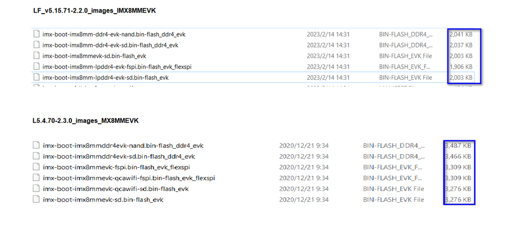

smithcoba
Here is your log.
Detect USB boot. Will enter fastboot mode!
Starting download of 2091712 bytes
downloading of 2091712 bytes finished
MMC write: dev # 2, block # 66, count 4086 ... MMC: block number 0x1038 exceeds max(0x1000)
The space you must have on boot1:
66 x 512 +  2091712  = 2,125,504
The space on the emmc boot1:
4096 x 512 = 2,097,152
2,097,152 -  2,125,504  =  -28,352
The emmc is 32G, it is user partition. not boot partition.
The log shows the boot partition is 2M big. That I have told you before.
If you use scard, the flash.bin can flash into it.
Usually, the NXP binary demo image flash.bin is bigger than 2M.
If you want use the emmc currently on your board, you must change the uboot configuration to make it smaller.

smithcoba
It seems the flash.bin size + boot offset is bigger than the emmc boot partition size 2M

smithcoba
uboot has command "mmc dev [dev] [part]"
From your log, MMC: FSL_SDHC: 1, FSL_SDHC: 2
mmc dev 1 switches to SDHC 1
mmc dev 2 switches to SDHC 2
Because   SDHC2 is emmc, you can
mmc dev 2  1  switches to emmc boot partition 1
mmc dev 2  3 switches to emmc boot partition 2
mmc dev 3 3 switches to emmc use partition.
Because the emmc boot partition is small you need to switch to use partition and flash the image.
But in the binary demo image, NXP doesn't provide the script to flash image to the emmc use partition. You need to write down by yourself, using such as  uuu download command..., etc. Manually flash the image to use partition.
But after that, you also need to switch to boot from use patition, using mmc partconf
mmc partconf 2 0 7 0. Note 7 is enable use partition to boot.
Another way, you can change the uboot configuration. Remove some no necessary module/configuration for your project to make the flash.bin smaller can fit the 2M emmc boot partition.
Maybe remove  the spi, ethernet ..., etc.

AlekseyM
That is not a solution.
The problem was solved with a decreased size of flash.bin
My DDR4 is configured fine and the log shows what ddr init and training were done.
