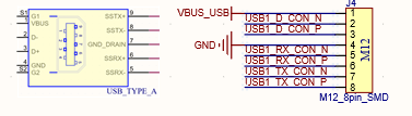

We are working on our prototype board, we pulled the Boot Mode 0 pin to high so MPU should be in Serial Download mode. For the prototype board USB, we only connected power, ground and data +/- . Is this configuration should work or we are missing out on something else?

Yes, your understanding is correct. Only four connections are required for the USB Serial Downloader mode.

Hello, may I ask if VBUS is required for the RT1176 MCU to be in serial download mode or at least to be recognized as a USB device by the PC?
