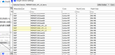

When you select the device, use the following _L1, or L2, that is for the hyperflash.

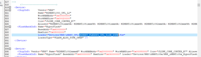

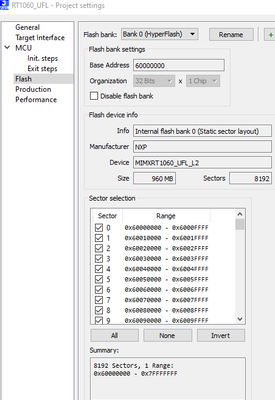

This provide solution does not make sense.  I've been working on implementing it, but the numbers representing the FLASH size do not make any sense.
When I compare to my working connection to my IMXRT1050-EVKB I see that the assigned FLASH is 64MB, as expected:
But the provided driver patch has the flash size at an extreme size of 960MB which is much larger than the expected 64MB.
This is what my .xml edit specifies:
<Device>
<ChipInfo Vendor="NXP"
Name="MIMXRT1060_UFL_L2"
WorkRAMAddr="0x20000000"
WorkRAMSize="0x00080000"
Core="JLINK_CORE_CORTEX_M7"
Aliases="MIMXRT1061xxx5A; MIMXRT1061xxx6A; MIMXRT1062xxx5A; MIMXRT1062xxx6A" />
<FlashBankInfo Name="HyperFlash"
BaseAddr="0x60000000"
MaxSize="0x04000000"
MaxSize="0x08000000"
Loader="Devices/NXP/iMXRT_UFL/MIMXRT_FLEXSPI_UFL_512B_64KB.FLM"
LoaderType="FLASH_ALGO_TYPE_OPEN" />
</Device>

kerryzhou
Hi @tbiberdorf ,

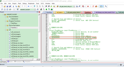

  This point is easy to realize, as the ongoing :MIMXRT_FLEXSPI_UFL_512B_64KB.FLM
is defined to the larger memory. ,_L1/2 used for Hyper Flash(Page size 512 Bytes,Sector size 4KB/64KB)
You can check the RT-UFL source code, in FlashDev.c, The above
is:
struct FlashDevice const FlashDevice = {
FLASH_DRV_VERS, // Driver Version, do not modify!
"MIMXRT_FLEXSPI", // Device Name
EXTSPI, // Device Type
0x00000000, // Device Start Address
0x40000000, // Device Size in Bytes (1GB)
FLASH_DRV_PAGE_SIZE, // Programming Page Size
0, // Reserved, must be 0
0xFF, // Initial Content of Erased Memory
3000, // Program Page Timeout 100 mSec
15000, // Erase Sector Timeout 15000 mSec
// Specify Size and Address of Sectors
FLASH_DRV_SECTOR_SIZE, 0x00000000, // Sector Size 4kB (256 Sectors)
SECTOR_END
That's why you find the size is large, as you know, our RT-UFL is not only used for the 64MB flash, but it also can support the large flash sizes.
So, if you care about the JLINK interface FLASH size, you totally can modify the RT-UFL source code, generate the new .flm, then test it again.
I think, now, you don't need to care about size at first, after your board RT1060+hyperflash can program and boot works OK, then we can modify the source code, that is easy to realize.
Kerry

I've made the suggested modification to my Jlink Devices file as you suggested:
<!-- NXP (iMXRT106x IoT / HyperFlash) -->
<Device>
WorkRAMAddr="0x20200000"
</Device>
and I am still unable to make any useful communication with my development board.
When I programmed my FLASH with the NXP-MCUBootUtility.exe, then viewed my FLASH memory with MCUXpresso IDE, I can see the MCUXpresso GUI FLASH tool provides details that it was successful in the erase of my FLASH part, but yet still shows that it has been programmed, see attached image MCUXpresso IDE view FLASH.png
I had modify the FLASH driver to many different options and none seem to provide any success in even erasing my FLASH memory.
Can anyone provide any useful suggestions that can show that the RT1062 works with HyperFLASH memory???

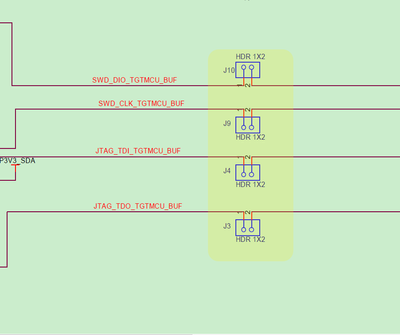

tbiberdorf
forgot to attach the schematic file
18,189 Views

3. When use the JLINK, please remove these jumper: J3,J4,J9,J10

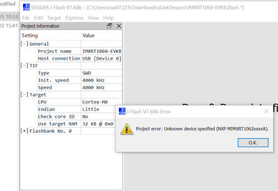

I've continued to attempt to get the suggested UFL code suggestions to work but it continues to fail.

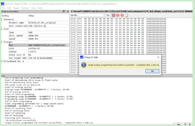

Now I do have the installed version of J-Flash version 7.68c working when I modified the JLinkDevices.xml file, please see attached zip of these two files.
I modified the flexspi_nore_config.c file to use hyperflash and made the needed changes in the project settings to support XIP operation.
I can use J-FLASH to program my target system, but I did notice that I need to first erase the FLASH before the program/verify operation will work, but after programmed and verified, I can then take the MXUXpresso debug configuration to "attach to running" settings and my IDE will attach to the modified code and allow me to view memory and step through code.
Why does MCUXpresso not support direct writing as it seems that I can perform these operations independent with j-FLASH.  Also when I attempt to perform all these operations with the IMXRT1050-EVKB everything works smoothly???
I continue to see many references to RT1050 drivers and such in the RT106x interfaces, so I continue to wonder if anyone has ever got the IMXRT1060-EVKB to every work with HyperFLASH.
Thanks for any suggestions.

Hi @tbiberdorf ,

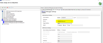

   So, now, which device name you are using in both the JFLASH and the MCUXPresso JLINK debug configuration?
   Normally, JFlash works, then the MCUXpresso IDE works, as the MCUXPresso IDE will call the related jlink driver, but you need to select the correct device name and the JLINK driver path.
   I checked your attachment:
Do you still use the RT1050? I mean, you select the device name as:MIMXRT1050_UFL_L2?
I open your JFLASH project, didn't find your device name:

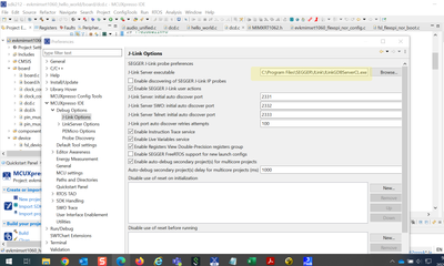

In the MCUXpresso IDE, debug configuration area, the JLINK device name should be the same as your JFLASH.
https://www.cnblogs.com/henjay724/p/15430619.html
The following picture also need to select the working JLINK driver file:
I have tested the MIMXRT1060-EVK+hyperflash, that works OK, as you know, EVKB is totally the same flash chip to the EVK.
Kerry

  4. Modify the Debug Configurations and replace the MIMXRT1062xx6A to MIMXRT1052xxxA
  5. Added the following Device to the Segger JLinkDevices.xml file:
    </Device>
    <Device>
    <ChipInfo Vendor="NXP" Name="MIMXRT1062xxx6A" WorkRAMAddr="0x20000000" WorkRAMSize="0x00080000" Core="JLINK_CORE_CORTEX_M7" JLinkScriptFile="Devices/NXP/iMXRT105x/NXP_iMXRT105x.pex" />
    <FlashBankInfo Name="HyperFlash" BaseAddr="0x60000000" MaxSize="0x04000000" Loader="Devices/NXP/iMXRT105x/NXP_iMXRT105x_HyperFlash.elf" LoaderType="FLASH_ALGO_TYPE_OPEN" />
    </Device>
18,164 Views
tbiberdorf
Sorry everyone but I made an error in my reply, step 4 below should be set to MIMXRT1052xxxB not MIMXRT1052xxxA:
18,160 Views
kerryzhou
Thanks for your information, so at last, still use the RT1050 hyperflash flashdriver, that's works with RT1060, as the RT1060 flexSPI can compatible with the RT1050 flexSPI.
So, just use that for downloading now.
