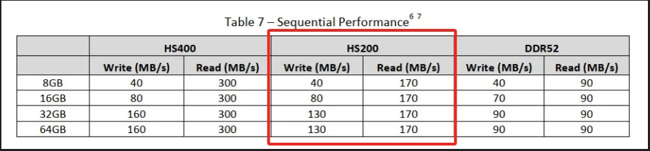

The eMMC on the IMX8MPLUSLPD4-CPU board I tested is SDINBDG4-32G, and the results I tested using PerformanceTest are as follows:
I have two questions:
1. The sequential read/write speed of SDINBDG4-32G in HS200 mode is 170/130 MB/s,
but the actual tested sequential read speed is only 43MB/s,why is it so much slower?
2. In HS200 mode, the eMMC clock should be 200MHz, but the frequency of the eMMC clock signal I tested is 52MHz? If it is eMMC HS200 mode, why is the clock not 200MHz?
