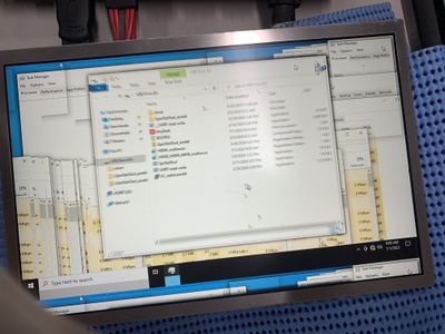

hankwang
Contributor V
Hi , thanks for the information. The 8MP EVK board can display 3 screens.
But I have a problem, although 3 screens can be displayed independently, there will be lag or confusion in 2 or 1 screen (Just like the picture below). When I set up 2 screens to sync and expand one screen. All screens are good.
 So is it not allowed to display three screens independently?

Michal_Minarcik
Hi @hankwang,
To set 3 displays independently, please follow below instructions:
Open regedit (Registry Editor) as Administrator and navigate to:
HKEY_LOCAL_MACHINE\SYSTEM\CurrentControlSet\Control\Class\{4d36e968-e325-11ce-bfc1-08002be10318}\0000
and change GdiAccLevel to 0
Then reboot the board and 3 displays can be displayed independently (extended).
