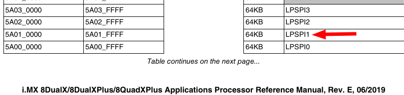

The HRM of the iMX8QXP shows there are four LPSPI buses:
The device tree however only lists three of them. LPSPI1 is missing and thus not available:
https://source.codeaurora.org/external/imx/linux-imx/tree/arch/arm64/boot/dts/freescale/imx8-ss-dma....
What's the issue here with LPSPI1?

Hi Hector
I asked internally, below answer
Indeed, the lpspi1 node definition is missing from the dts, most likely because it can't be tested on the mek board.
But the definitions for the pinmux options for the lpspi1 external signals are already available in include/dt-bindings/pinctrl/pads-imx8qxp.h
As an addition to what you already provided in the public thread, you can also add the property necessary to be able to use the dma.

Thanks @igorpadykov but the fact that LPSPI1 is not suitable for the MEK doesn't justify that the bus itself is not defined at all on the imx8-ss-dma.dtsi DTSI include file.
Besides, IMX8QXP_SPI1_xxx defines are missing from include/dt-bindings/pinctrl/pads-imx8qxp.h and thus not used either on drivers/pinctrl/freescale/pinctrl-imx8qxp.c
Do you have values for those? Because it looks like this bus and pads are completely missing from the BSP. That's why it looks like intentionally left out stuff.
