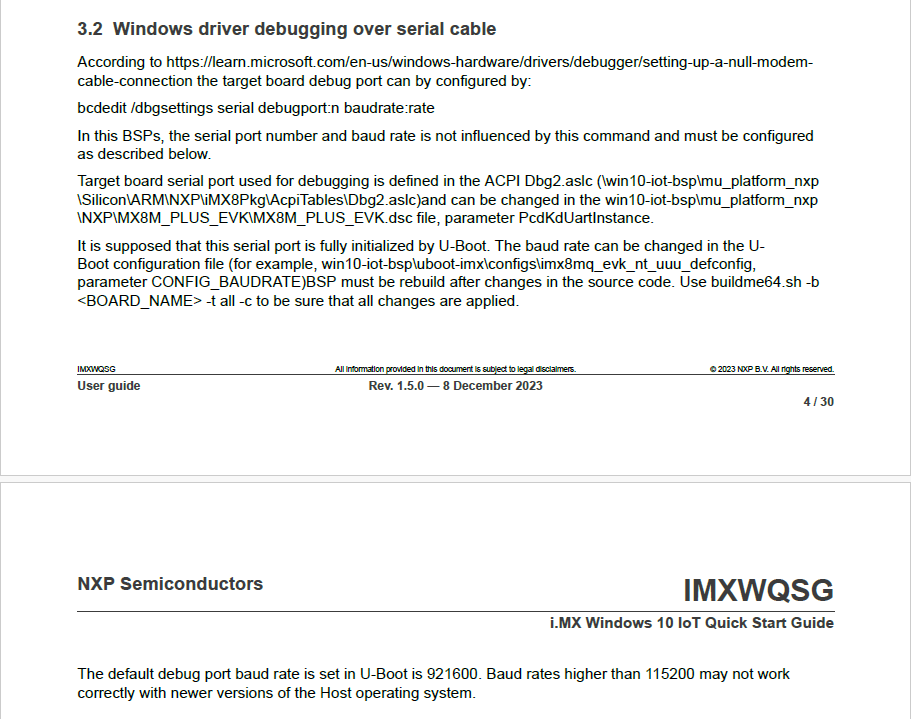

If W21H2-1-5-0-imx-windows-bsp.zip doesn't include COM Ports in the Windows 10 21H2, how do we configure WinDbg to debug Windows Driver?
So far we read i.MX Windows 10 IoT Quick Start Guide (IMXWSG_1.5.0.pdf - Page 4/30) and try to follow introunction to configure COM Port for debug.
Or we have wrong understanding about this description.
Can you give us some advice how to enable/configure Serial Port on iMX8M Quad EVK when it boots up into Windows 10 IOT 21H2?

to configure WinDbg two commands :
bcdedit /dbgsettings SERIAL DEBUGPORT:1 BAUDRATE:921600
bcdedit /debug on
(make-winpe-enterprise.cmd can be used for inspiration)
need to be run on a target board to configure kernel debug over serial port. The same port, as U-boot uses as console output, is configured in the BSP by default.
This port is needed to be set up for WinDBG on the host computer. For example:
Start WinDBG
Open cmd as Administrator
"C:\Program Files (x86)\Windows Kits\10\Debuggers\x64\windbg.exe" -k com:port=COM3,baud=921600
aslc and dcs files need to be touch only in case when you want to change the UART used for the debug by the target Windows system.
Please be aware that there is a caveat. When baudrate over 115200 is used, Windbg do not want to get connected to the target machine. It was found, that when any VM is running on the host machine, than the Windbg is able to connect over the serial port to the target. So please run for example Ubuntu in the VM virtualBox. It is unexpected, but working solution for this connection issue.
In short, on EVK with unmodified NXP BSP, you only need to run the commands on target's admin command line:
bcdedit.exe /dbgsettings SERIAL DEBUGPORT:1 BAUDRATE:921600
bcdedit /debug on
Then on host computer start WinDbg with same COM, as on which you are able to see uboot output with serial terminal like Putty. (while Ubuntu is running in VM).
