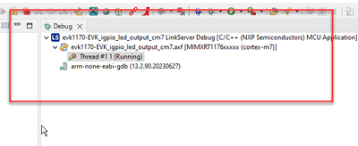

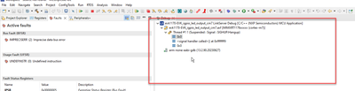

I have the MIMXRT1170-EVK and the new SDK_2.15.000_MIMXRT1170-EVK-OM13790HOST_ConfigTools_data. All code examples for the M7 core don't work.
I try to use the M4 with the igpio_led_output_cm4 example and it's works fine.
But the igpio_led_output_cm7 example does not work. It seems that all  examples with M7 don't work either.

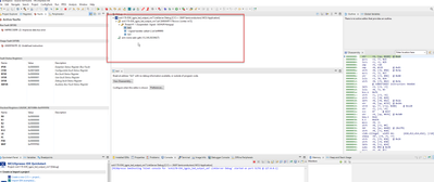

Veronic
Thanks for your help, but  the problem seemsthe USB policy of my company!!!!!! On my personal PC is working

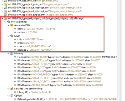

If I am understanding correctly you hardware is RT1170-EVK, right? But I see that the associated SDK is for RT1170-EVKB.
Could you please double check?
I just tried a Wi-Fi example (which runs on CM7) and it is working correctly with RT1170-EVK SDK 2.15.000.
Daniel.
