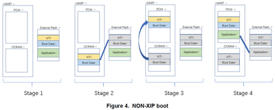

We have started working on IMX1170XEVK board and we curious to verify non-XIP execution using NOR.
We didn't understood the exact meaning of below sentence from the IMX1170X reference manual page no:286.
"Both booting an XIP and non XIP image are supported from Serial NOR Flash. For XIP
boot, the image has to be built for FlexSPI address space; and for non XIP, the image can
be built to execute from internal RAM.
Can you please elaborate what it means exactly ?
9,964 Views
jeremyzhou
As @jay_heng mentioned before, for the XIP image, the application is stored in the Nor Serial flash whose address map is consistent with the link address, however, for the Non-XIP image, the link address usually is the internal RAM, so the ROM code needs to copy the application to the target address prior to jumping to run, just like the below figure shows.

7,597 Views
djarin
Hi, from your figure, in stage 4, what happen if the application size is larger than ITCM?
I am using imxrt1064, and factory default ITCM size is 128K, and we not intent to increase this size, and we have large enough SDRAM, can we modify stage 4 so that the application will load into SDRAM?
9,967 Views
jay_heng
Yes, we can store Both XIP and Non-XIP image in NOR flash, these two kinds of image can be booted by ROM.
For XIP image (it is linked from 0x30000000/0x60000000), BootROM jumps into it directly.
For Non-XIP image (it is linked from 0x0/0x20000000/0x20200000), BootROM copies it from Flash to dest address then jumps into it.
